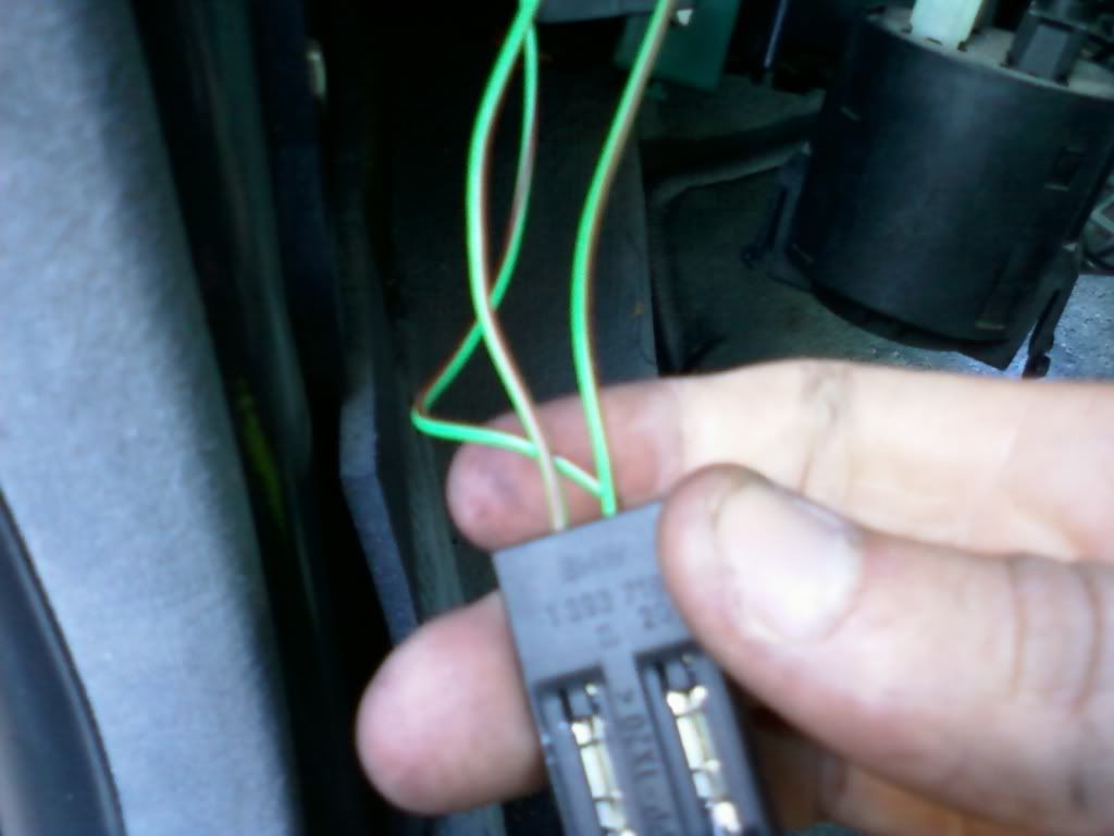

Sorry for the noobish first post, but I've searched everywhere to get rid of the DRLs on my 1993 325is.
Luckily I found this thread, however I am having significant difficulty finding the 5 green/red wires as mentioned.
Can anyone confirm that the wiring colors on 93 and 94 were the same?
Gonna go back and try to find those wires again, but any help in locating them would be appreciated.
ie where they start so I could trace them back.
Thanks
edit
took a couple pics, still no luck
first picture is of three green wires with red stripe, I took the whole splice panel out and examined it and this is the closest thing I could find to 5 green/red wires.
second picture is of the connections right behind the headlight switch.
Where one of the green wires with red stripes connect. Is this right?
Again, any help would be appreciated.
Has anyone successfully done this on a 93?

I don't know why it is different.
So on your car there were five and only five green wires with a red stripe?
mine just has the three as pictured, I'm wondering if I should mess with them or not.
Do you know which one of the green red wires runs to the headlight switch, if any at all?

UPDATE OF MY FINDINGS:
Don't hate on me , this is still experimental. I just used the tape so I can still be able to unhook it and try diffrent combinations so I can turn the dash lights and parking lights off.
The 3 wires, the one with RED tape is a headlight switch, the one with BLACK tape is Low Beam Relay.
The middle I got no clue yet but I connected it to the yellow wire (both ends) and my low beams started working on the switch.
The Parking lights and dash lights are on constantly ON but the low beams are on a switch with this type of wiring.
Dan Bro is offline   Reply With Quote
Old 11-11-2009, 03:53 PM   #26
ThisGuy310
Join Date: Nov 2009
Location: South Bay
Posts: 10
so did you cut all three wires from the splice
then connect the middle to the yellow wire
and connect the remaining two wires to each other
am I understanding this correctly?
ThisGuy310 is offline   Reply With Quote
Old 11-11-2009, 03:55 PM   #27
Dan Bro
Dan Bro's Avatar
Join Date: Sep 2003
Posts: 356
I cut all 3 wires (RED/GREEN) , I connected the outside wires together.
Then I cut the YELLOW WIRE and connected both ends of the Yellow to the Middle (RED/GREEN) Wire....
